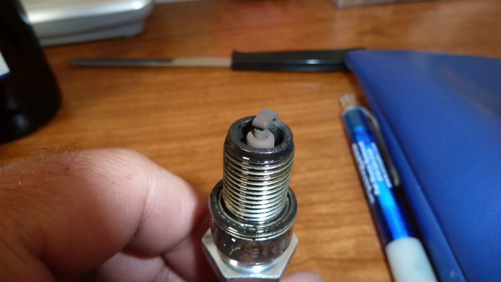

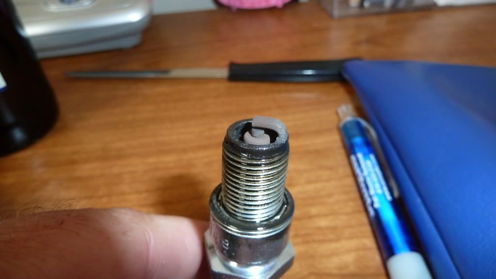

Ok, got the hose at NAPA, $13. Put it on and took to the lake today. Still doing the same thing. Slight missing at WOT & seems like it's off 1k rpm.
You may want to check your plugs or replace them. That happened to me and I fouled plugs before I figured out the problem.
