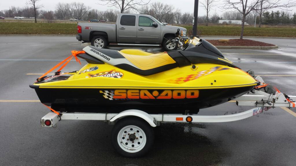

Since my current restoration is entering it's final stages ( http://www.seadooforum.com/showthread.php?81804-95-xp800 ) I thought I would go ahead and pick up another restoration project.
This 97 SPX was listed on Craigslist for $350 OBO, I shot the guy an email on Thursday evening with an offer of $250. He accepted, and on Saturday, 11/19/16, I picked up my new baby.
The engine is low on compression, and the seat was lost to the highway gods. Everything else about the ski is practically mint, and came with a factory cover that has some fading, but no tears.
Plan is to rebuild the engine, do the carbs, and fuel lines. I've got a spare seat that needs recovered, and I'll add mats. Other than that and a good bath, the hull is so clean it doesn't even need a hosing out. Scratches on the stickers are purely on the stickers, there's not even a scratch on the rear grab bar.

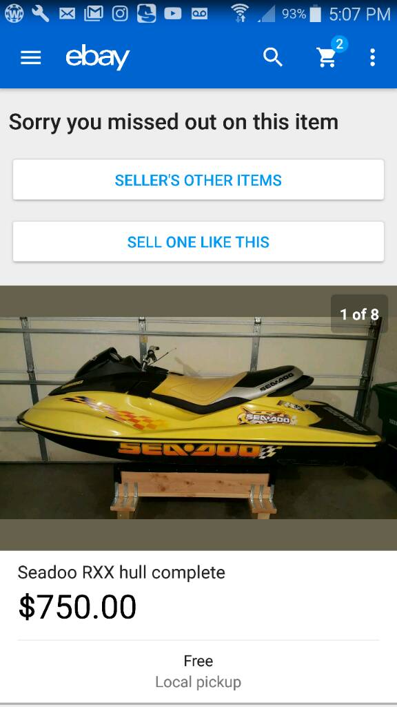

The replacement.
The hull is about as cherry as you can get. The twins, pump, and mpem are all long gone, but the rest is immaculate and will make a very nice ski.
Someone sent me a screenshot of it for $600. Normally I'd have it shipped in but I just didn't have space at the moment. Glad to see it went to a member.
Dang. I didn't know 600 was such a good deal. I was 20 min from the guy selling it, didn't think it was worth it but I guess I was wrong.
The steering and the seat are worth more then $600. The hood is big money also because it fits the big four strokes. For them it's like getting a single gauge mirrorless yellow hood of an XP800, but even more rare.
