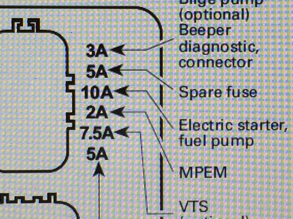

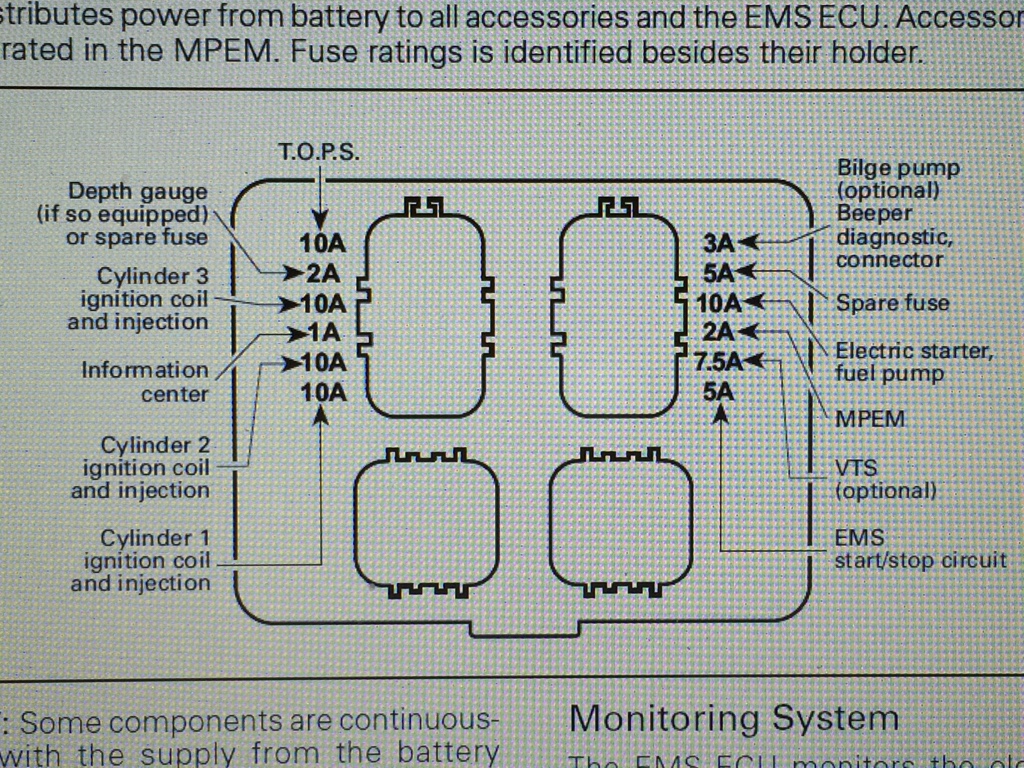

I found where the fuses are but don't know which one is for the fuel pump. Can you tell me which one it is? Thank youfuses.jpg
In the MPEM
For some reason I can't upload the picture.
Top right should be 3 amp. Just below that a 5 amp (spare fuse). Then a 10 amp. The 10 amp is the Fuel Pump fuse.
Ok. Was able to upload the pics now.
