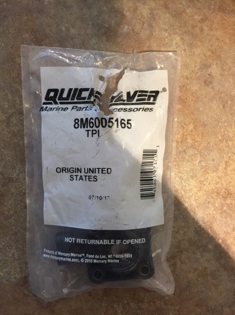

I have my 2001 Challenger M2 V6 in a shop now as it loses power above 3400 RPM's, they have run out of ideas on what the issue can be. They even had a Mercury rep on it also - still no joy
They have said that 2 & 5 are dropping, but intermittently, but not sure where to go from there. They gave me a list of the other things they have tried also:
Does anyone have any other ideas/pointers to what this could be?
Thank you in advance for any help you can offer here!
