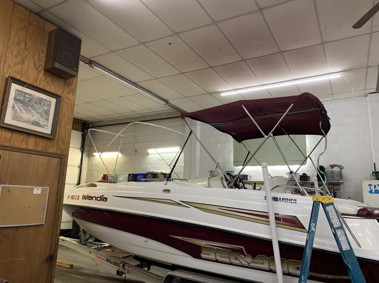

Today’s progress.
Does anyone have a front Bimini currently? I’m trying to figure out how I’m gonna STOW the front Bimini when it not in use.

#18
Cushion looks great. Is there enough clearance where you can still open the change room door??
I found this pic of an islandia with the front bimini stowed also.

Thank you for that! We made progress today but dang it I forgot to take pictures!
My concern is blocked navigation lights and I hate to admit it but the thought of the front Bimini having to be “stowed” possibly in a leaning forward position (opposite to the rear) in my opinion doesn’t look to good. But if it’s leaned backwards then it would block the opening of the bathroom.... What’s a girl to do?

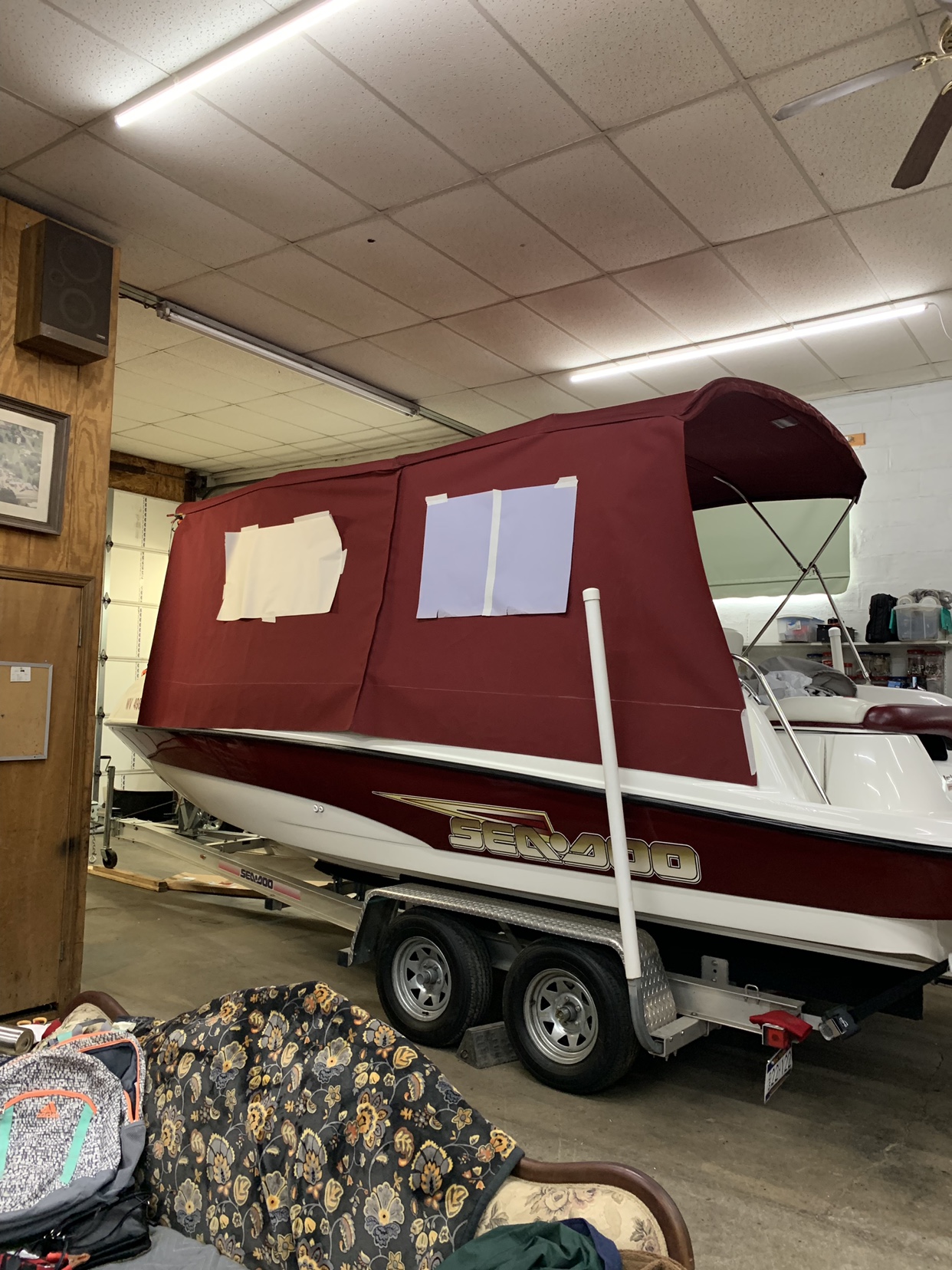

My upholstery guy got a virus and we’ve not done very much the last few days. We did hang a sheet around it this morning to get a rough idea of what the side curtains will look like and how we plan to wrap around from the sides to the front. 02A3EC9A-3200-4818-812D-E856611E03A4.jpeg

Today’s progress - no work tomorrow. We’ll start back on Friday.
