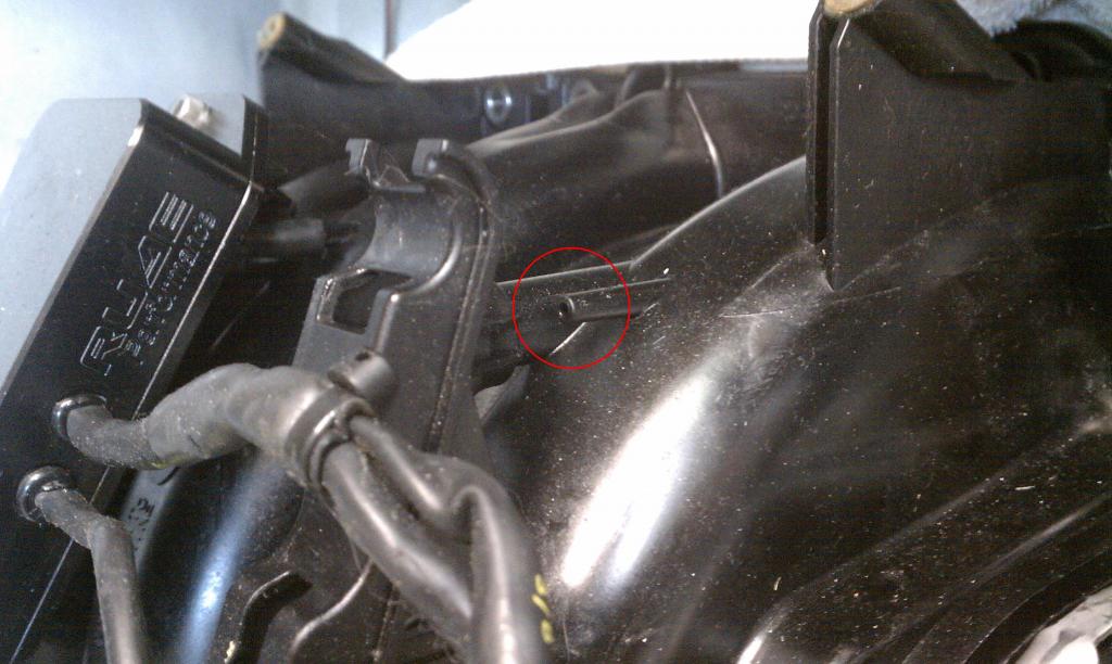

Not bad now for the other dumb question. Where's the best place to tap in for a boost reading on these 4tecs? I've asked the question before and it went unanswered.
There are 3 nipple ports on the manifold, that you can heat up and poke a nail through it and attach your hose for a boost gauge... also you can drill and tap your supercharger exit

Can you post of pic of those nipples?
i sure can... this isnt my picture but one i grabbed from another website..
the three nipples are right on the intake manifold right below the injectors.. some guys say drill some say just heat and push a nail through it.. id rather drill but put a little bit of grease on your drill bit so the plastic shavings dont enter the motor.

cool thanks. i'll have to order one of those here in the next few days. now i just have to figure out what other gauge to fill that other hole with.
