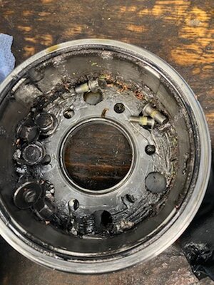

My 2016 RXP-X 300 sheared off all the flywheel bolts, destroying the stator, flywheel cover sending filings from stator which look like fools gold thru-out the engine. So being my machine has 115 hrs I'm being told Sea Doo most likely won't cover anything. This is a defect in the Sea Doo engines according to several post. RIVA racing is also aware and provides a high performance flywheel bolt. Just thought a possible explanation for this so called fools gold might save some Sea Doo owners the headaches I'm facing. Sea Doo should take ownership of this issue if they're an upstanding manufacturer. 20181028_170526.jpg

If you want to sell the ski I may be interested
Will need full strip down
