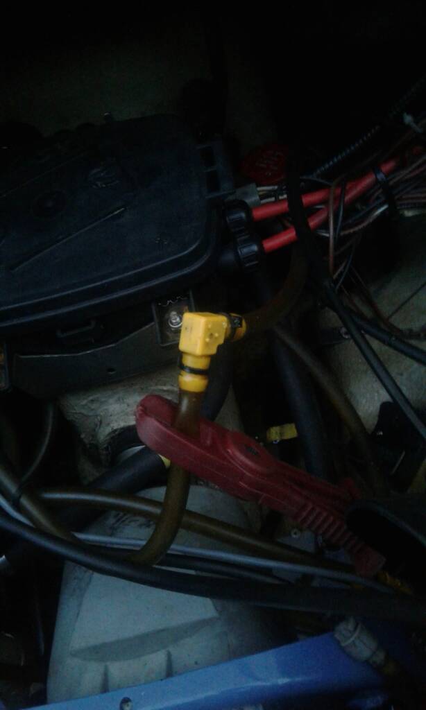

Please tell me what this is?
whitewheels
Got two of these and when boat sits at dock it's pouring water from one of them. I suspect that this is my leakage problem
Those lines look like the go to black boxes on the bottom of hull to suck the water out. But boats usually have a bilge and the siphon tubes
Those lines have to be hanging up so water does not siphon back inside. Works with pump
If you have a leak also check exhaust and around carbon seal.
That clamp should not be there.
Checked all the usual leakpoints,even filled the compartment with water.
Those yellow ones is hanging down. Saw some pics from a ski and they where tied so they was hanging way above. I'll try that
those yellow elbows must sit above the water line or they will leak. as the water comes out of the jet pump it pulls a vacuum on those lines and sucks the water out of the hull
Look in the rear... up toward the top. I'm guessing you will see a couple hooks for them. Depending the year, it will either slip into them, or need zip tied up. But as others said... they need to be above the water line, or water will flow into the bilge.
