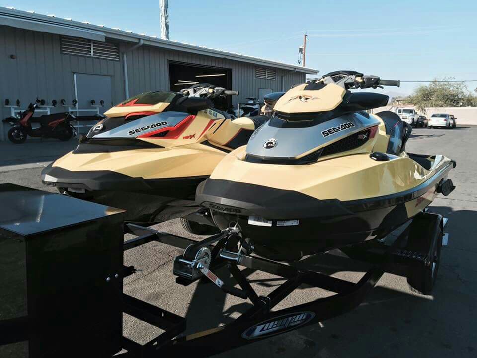

Hi : first let me express my regret over your purchase of two sc , 2015 Sea Doos
