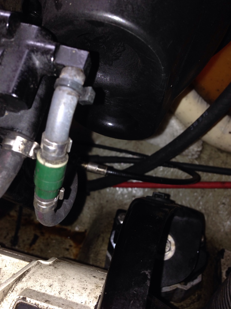

I am not sure. This is one area I am confused about. The small fuel line from the accelerator pump that splits to two lines for the carbs had something inline that is not in any parts diagram. It looks like a check valve. Therefore, other than check to make sure they were in good shape and clear passage I have not messed with those lines. ( did not replace). I as told this was a mod, but again, I bought this ski new in 97 and it came from the factory with this item inline.
Where would I find this restrictor within the fuel system and what is the purpose of it?
That check valve you are talking is most likely the restrictor... It's just there to stop the accelerator pump from shooting in a huge shot of fuel off of the idle transition.... Maybe post a picture of this check valve?
Here is a picture of it.
Yessir that's just a check valve..... I'm talking about an inline restrictor that's actually inside of the fuel line coming from the acc pump... Should be a small brass piece that looks like a carb jet
Being as I only removed the other ends from the carbs when cleaning, they should still be in there providing they were not missing from factory, correct?
Yessir, if your confident the lines are factory and haven't been messed with or replaced then it should still be in there
Also, any ideas why this check valve would be there when it is not in any diagram and since there is actually check valves in this circuit on each carb? No one else seems to have this inline check valve, however, mine came this way from the factory.

That green check valve is pretty crazy looking. Depending on if it's spring loaded it might actually serve a purpose if it were on the other end of the fuel line at the tank (as an USCG required anti-siphon valve).
It is right ( like 1 inch) from the a-pump.
Oh, it's in the a-pump circuit? I thought it was in the main fuel line.

It's entirely possible your green check valve in the a-pump circuit must be there yet is undocumented, especially if this was one of the early models when the a-pump was first introduced. You may recalibrate the original carbs to the earlier spec that didn't use the a-pump by installing a larger low speed pilot jet, etc. if you choose to eliminate the a-pump for some reason, such as if the internal diaphragm is damaged or other a-pump parts are broken and no longer available.
