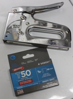

And here is the weapon of choice - a standard Arrow hand stapler and stainless steel staples. I love the label on the box - "Not for marine applications". Onward we go!

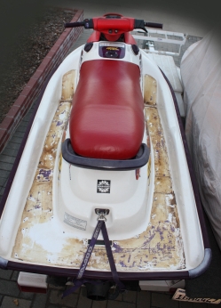

Well, here are photos of the newly covered seat on the boat.
As expected, the color is not a dead-on match. But given what this boat has been through, this is a big improvement over a torn seat.
And as you can see, I am in the process of replacing the mangled purple mats. Hydroturf is good stuff, but even so it has been abused to death. My plan is to put on black mats, black handle grips and replace the red start button. This will freshen up the overall look.:)

All righty, here is how it is turning out:
I was inspired by faded's GSX photo->I removed all of the big graphic decals from the hull on the starboard side. I left the GSX logo since it is still in good condition.
The port side is in the shade and is taking a lot longer to remove. Once things warm up later today, I can can continue peeling it off.
