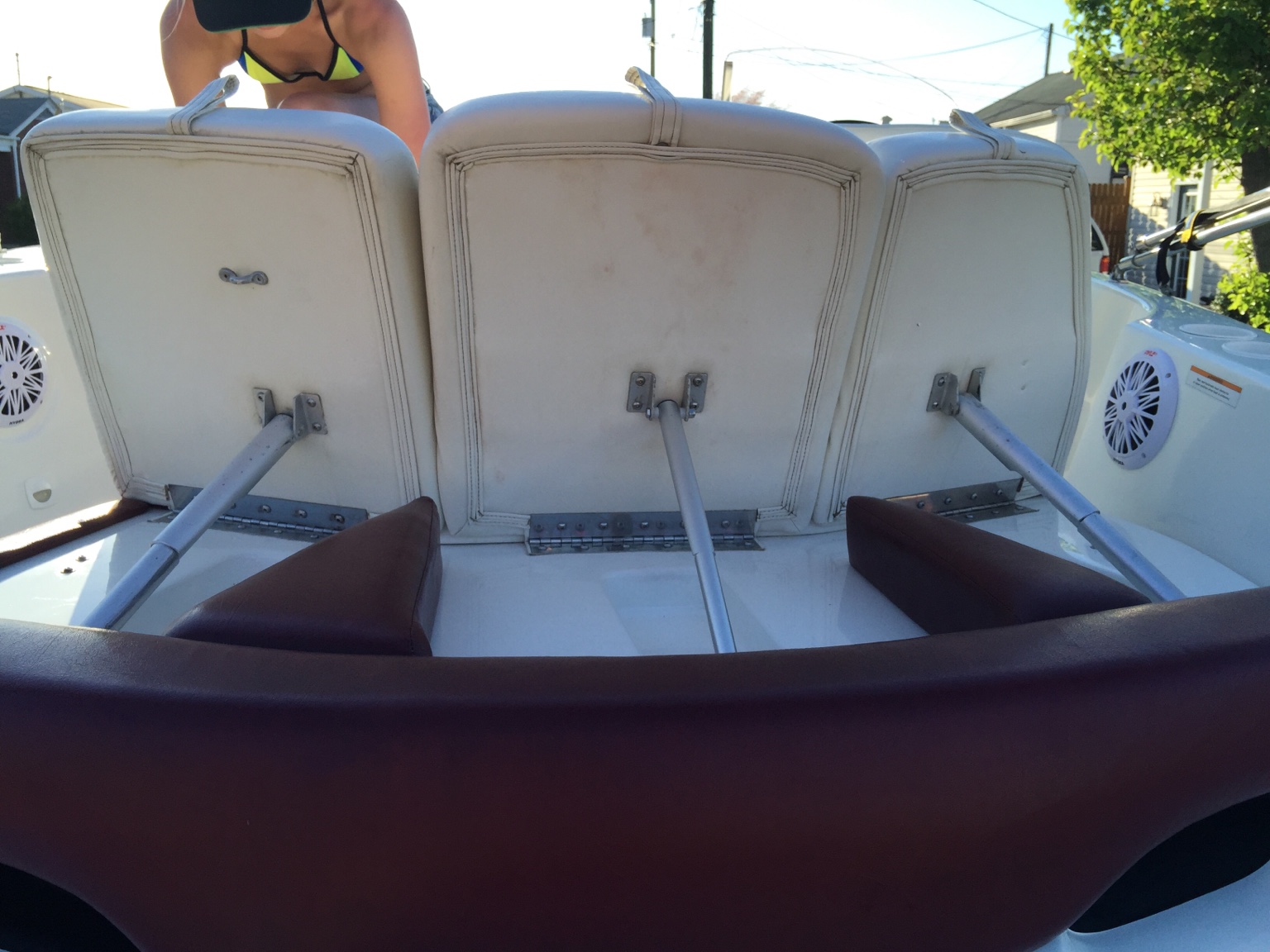

Dr Honda, my center one is not only broken at the hull bracket but the guts are junk. The seat farthest starboard the insides are seizing. I've used warm soapy water, PB Blaster, a lubricant spray that heating and cooling guys use to free up seized parts with NO luck. My port side is just not smooth. So if I'm gonna replace 2 then I might as well do 3. LOL
Now...Here's a question for you. Is there metal under the hull where they screw in or is it just the screw into fiberglass? I plan on using grabber pop rivets.
As far as I know... it's just screws into the glass on those. But, I'm going to get my boat uncovered in the next day or two, so I will check.

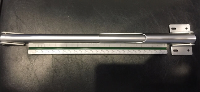

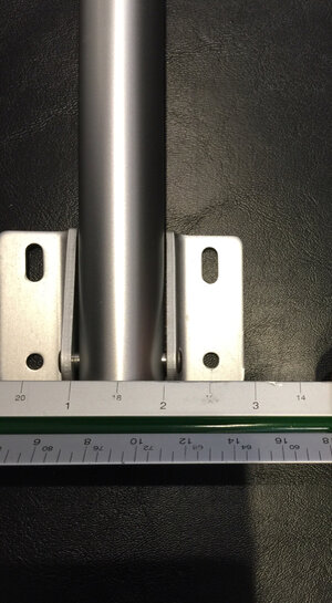

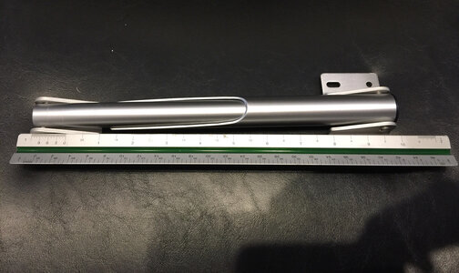

anyway. . . It is the correct length but the diameter is smaller. We shall see if that matters in longevity that is IF I can get it mounted. They sent me this one by mistake. The correct ones are on their way.
Since the diameter of the new support bracket is smaller, the new seat bracket do not match the existing bracket holes in the seat. These brackets are screwed into p/n 20410002 Tee-Nut 1/4"- 20 which I am assuming is behind the strong backing material of the seat whether its wood or plastic. We cut the brackets off the old one and reassembled it to the new one using a 1/4 dia x 1.5" bolt (should have used 1.25"), 4 nylon 1/8" washer (to make up the space difference. So this should bolt to the existing holes in the seat. . . easy breezy (cross fingers).
Mounting the small bracket to the hull is another story. I'm still working on that. Originally there was a stud that came UP from the bottom that is not accessible on the center seat. Pop Rivets are out as an option at this point because they would have to be 1" long. We already tried 3/16" grabber pop rivets and they are to short. I'm off to Fastenal to get some coarse thread SS screws in a couple diameters to see what works best. Will report back.

As far as your question about the backing, or support... looking at mine there isn't a visible backing. BUT, on the far starboard side... it looks as if the glass is bulged in such a way, that there is a support inside. I know that's not an exact answer... but it's what I can tell.

Required fix required 1- support (per seat), 1- 1/4" x 1.5" hex head bolt, 1/4" plastic washers that total 1/2" in thickness (I used 4 that were 1/8" thick) and 1- 1/4" lock nut.
