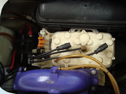

How do I take the carb out?
tractng
Is it the bracket next to the filter must be unscrew?
I tried taking out the cover but the two clips inside is a pain
I unbolted them but its not really moving.

Take the cover off. There will be 6 bolts holding the airbox on. Once it's off... you will see 4 bolts going into the carbs. (2 if it's a single carb) and then the bolts on the bracket. Once that's all off... then there will be 2 bolts in each carb, plus the cables, and fuel hoses.
