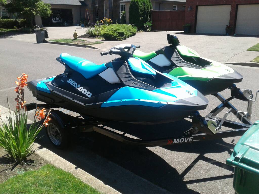

GTI SE 90 HO ACE Slow as Hell!!!
Mbell7319
just bought 2.5 months ago. (16 hours).
It's the same engine as the spark 3up.
However, the body is a little wider.
On a good day, I can get up to 42mph...
I'm so disappointed in this purchase because I get smoked by every machine on the water!!!
Do you know of any options for Me?
Please help!!

I get 50mph on the spark. How much does the GTI weigh? seems to me it probably weighs quite a bit more and/or has a larger pad in the water when on plane. The 90 ACE is a blast on the spark and top speed is just fine at 50 I wouldn't really want to go any faster on that light weight little thing. Doesn't seem like a great motor for a heavy bigger ski though.
They didn't try to hide that the top speed was around 42. I see what they did tried to get the price lower but I'm not sure if it was a good move. Some people will be happy with it and it is a lot better on gas than the 130. It is a trade off. It weighs about 250lbs more than a spark and my guess is it rides lower in the water so there's more friction slowing you down along with the weight

More weight, larger ski, pretty much everything you don't want. Sounds as fast as a 60 spark. Sorry dude
