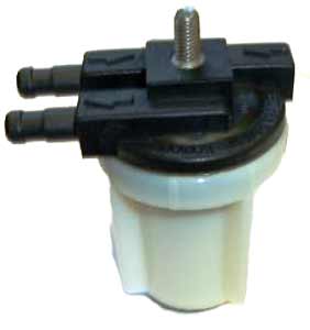

cracked fuel filter if you have one,

check your fuel water separator.
they can develop little cracks that you can't spot visually.
I've had those go bad on me twice.

I would get gas in the bilge only when the Ski was ridden. Turned out it was the fuel filter / water separator. A 14 year old tired gasket.
