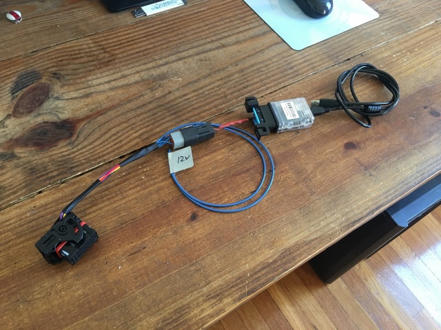

you need:
"rotax extreme"
"dongle"
"brp 6 pin > obd2 adapter"
purchase here: http://bitbox.ru/en/howbuy
tactrix open port
purchase here: http://goo.gl/0dP4oh
this will allow a VR (virtual read) of ecu and flash of ecu with tuned file from a tuner.

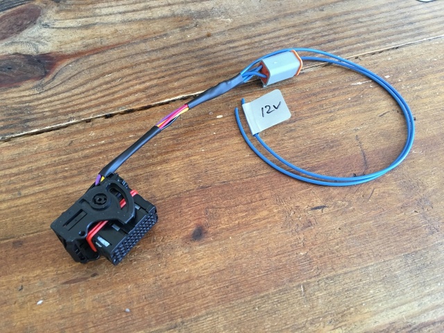

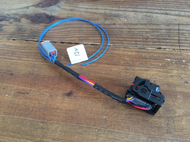

seadoo spark ecu bench harness.
can be fitted with obd2 connector instead or as shown with brp>obd2 adapter.
can be used to flash spark ecu on bench with proper tool (as shown in picture) or very useful for candboo/BUDS tool access outside of ski as well.
You selling the harnesses Ian?
