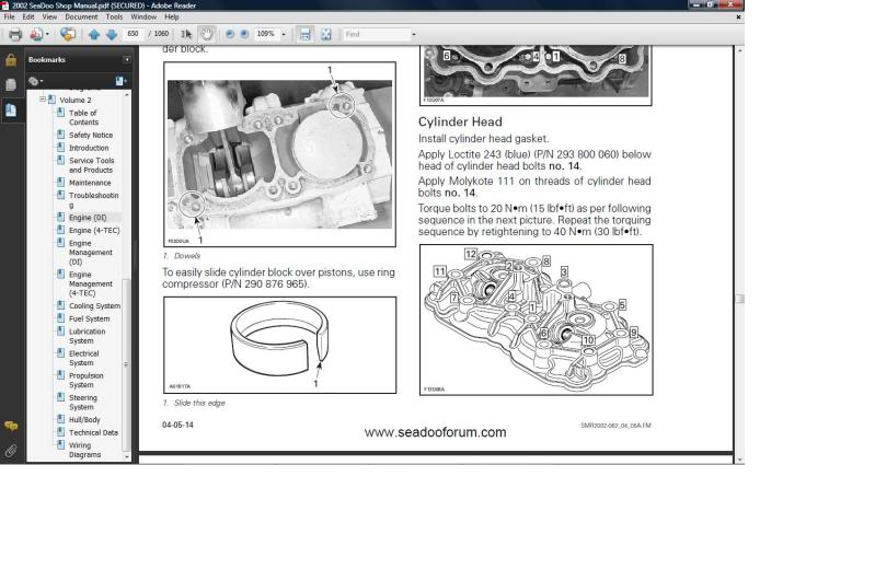

During winterization I dropped something through the spark plug hole and had to take off the head cylinder to get it. Does anyone have a link to the bolt tightening pattern as well as how much i should torque them?
Also if there are any other helpful tips I should know while doing this it would be helpful as this will be a first for me. Thanks
