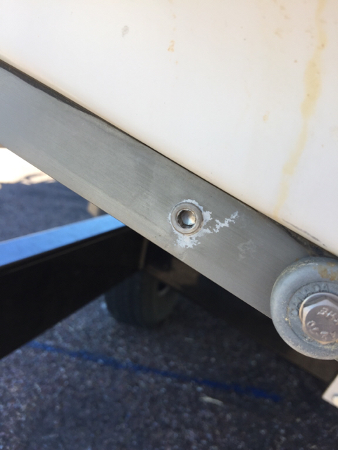

Does anyone know the size of bit required for the rideplate on 2010 Challenger?

That's not the ride plate, that's your heat exchanger (radiator in car terms) drain plug. It's a PIPE PLUG SOCKET HEAD 1/8-27 NPT. 1 of mine stripped out when I tried to remove it. Had to use an extractor to get it out. Replacements are cheap.

Haha! Ok. Thank you for helping me with my terminology. I knew what it was for just not it’s proper name I guess. Thanks for that info…I ended up using a T30 that worked pretty well but before that I tried an Allen wrench & could see it possibly stripping pretty easy. I will order up some replacements so in 2 years I can replace them. I couldn’t find the info in the manual but perhaps my terminology was steering me wrong there as well. Thanks for the help.
