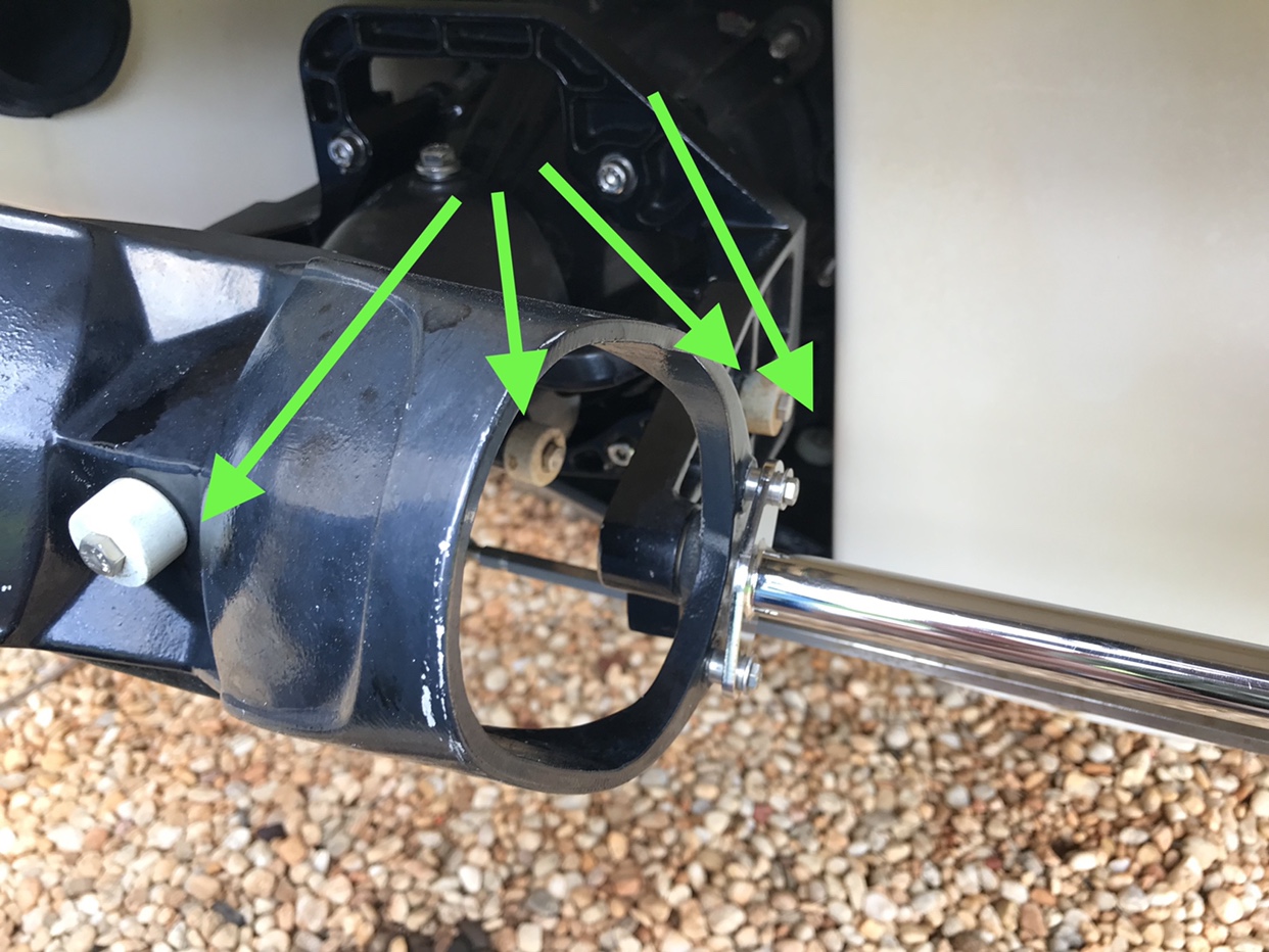

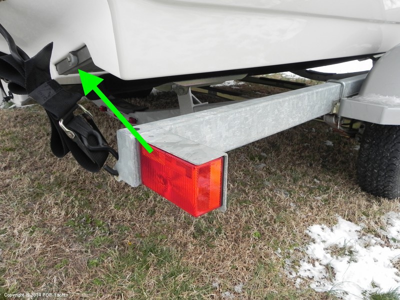

The anodes need to be replaced when they start to degrade. They should be corroding instead of your reverse bracket. There are 10 anodes on my 210 Challenger.
After seeing what yours looks like yes they do need replaced. Mine are much smaller and rounded. Thank you very much for the pics I didnt realize how much they were were out.
