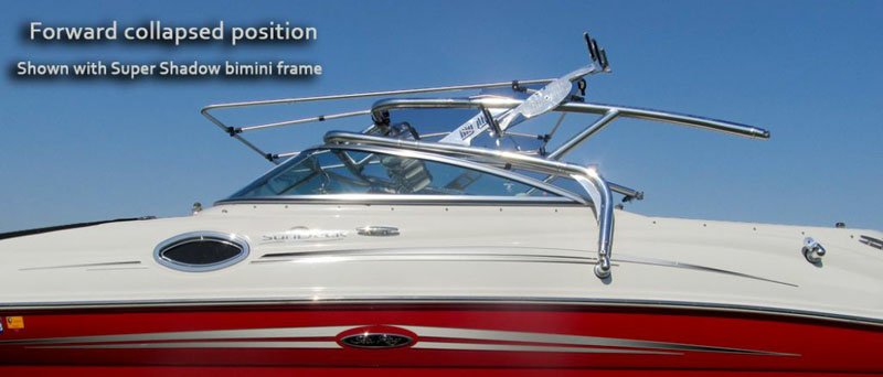

Awesome, thank you!!. One last question and I'll stop bugging you lol. You don't happen to have a pic of the tower in the folded position do you? And is that speedster only running one battery?
It's supposed to fold by unhooking the rear mount like this.
