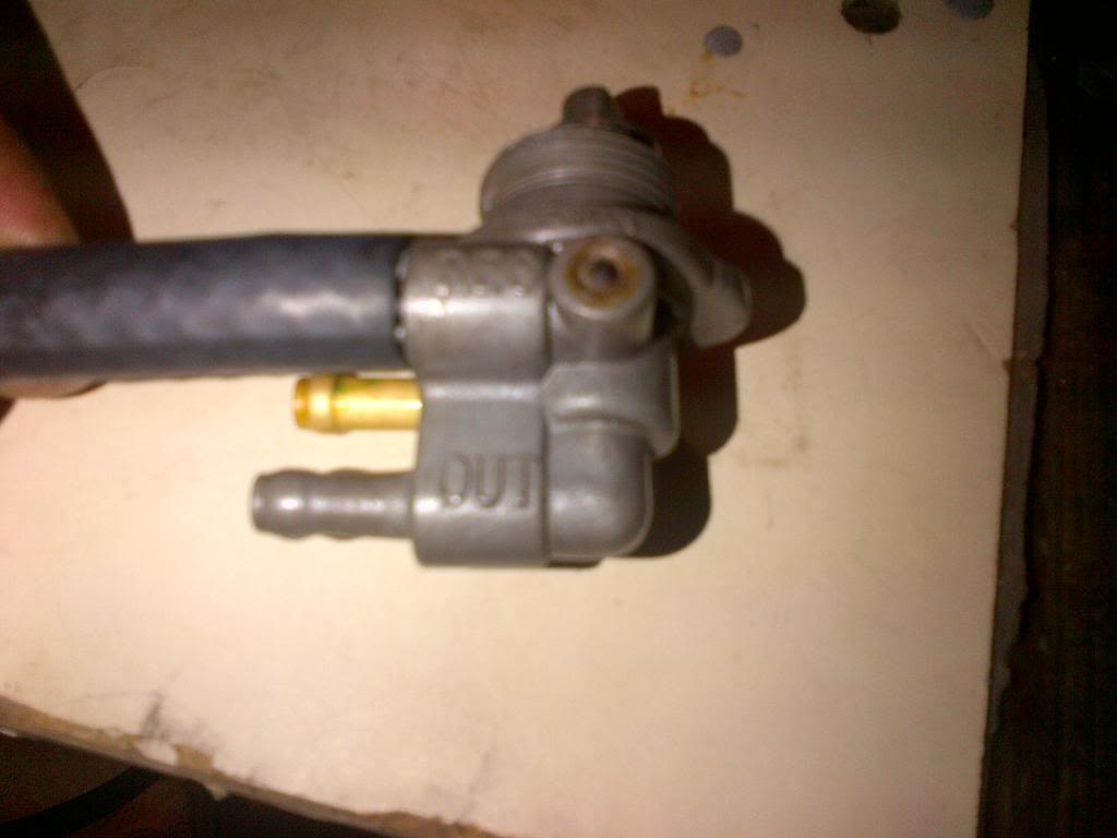

Everyone is right I would not take a chance. My 96 GSX plugged up and left me stranded. I replaced with clear fuel line and a clear inline filter so I can see if the fuel is reaching the carbs. Helps eliminate any questions of fuel delivery.
Take the selector switch out and replace or take apart and clean it out too. Also at bare minimum clean the small filters in your carbs, but it probably be a good idea to pull apart and clean them, especially if the filters are dirty/plugged

The fact is that ethanol eats the lines, turning them into a green/grey mush that will clog the fuel selector, filter, and carb filters, leaning out your engine and running it hot until it gives up. Usually when you are 10+ miles down river of the launch.
Find some time and replace the lines. It's not that hard. 20' of 5/16" and 5' of 1/4" for the fuel line return.
You will need to pull the carbs and get some screw clamps to do the ones between the carbs.
I just did this to a 2000 GTX; and the fuel filter under the hood was so cloggged I just tossed it.
The fuel selector switch was caked with white goo. I cleaned it out w/a screwdriver and carb cleaner.
The carb filters were 90% full of black gunk.

Regarding cleaning the fuel selector, definitely a good idea but one word of caution. If yours has the small set screw in the side that can be removed to pull the selector apart, please note that the part that comes out has an o-ring, but more importantly, inside the other piece is a rubber insert. To the untrained eye (mine, for example) it looked like gunk so I went about trying to clean it out, only to ruin the rubber insert instead. Not a huge cost to replace the selector (rubber insert replacement is not available), but with 20/20 hindsight I realized mine was just fine until I messed with it... live and learn.
