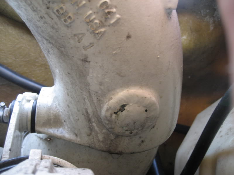

Also, found a crack in the exhaust with water leaking out... could this be causing my issue?
The crack will leak water, and you need to weld it up. (it's just superficial, and it's int he jacket)

JB Welded the small leak in the pipe. I prepped the surface well and hoping that it holds up... we shall see

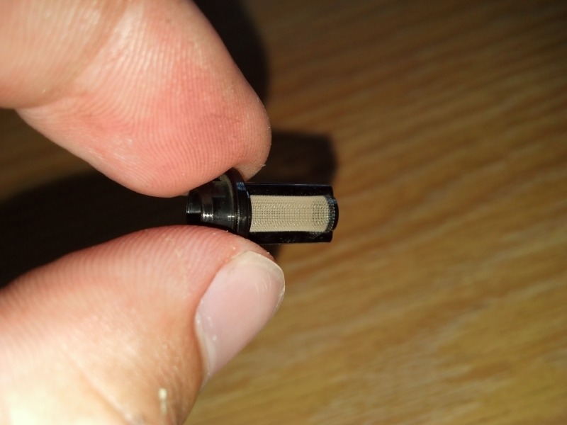

I then took the carbs back off. I did much more reading this time and found out what I needed to do from the sticky threads on this forum. Take a look at my screens. The MAG side was about 75% blocked up and the PTO side was almost 100% blocked up with debris. I cleaned them and took all parts out and cleaned all needles and all passage ways.
before
after

Tested the ski over the weekend. WOW!!! It runs decent now after going back through the carbs and cleaning them more thoroughly (I missed the little filters the first time as I was unaware they existed).
