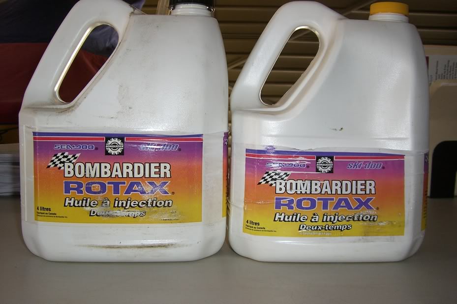

What about the injector oil, it is original Bombardier rotax injection oil that is 15 years old (never even burned through the 1st tank).
Should I empty the tank and replace?
What about changing the oil injection lines also, is this recommended on my ski
Thanks
If the oil was a know good brand. (like seadoo XPS) then I wouldn't drain it. If the oil is "Unknown"... then yes... drain it out, and change the filter.
BUT... I would check the small injector hoses. Just give them a squeeze, and twist. If they rip... replace them.

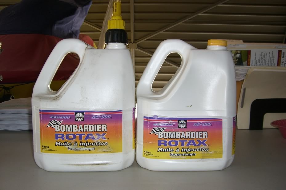

Here is the oil that is in the tank, straight from 1997.
Should be drained & Changed to the new Seadoo SPX in the yellow bottle?
Bump...anybody know if this is good oil or should I change it after 15 years?
Thanks
Sorry.
Well.... on your engine, they recommend the new synthetic oil. It protects better, and keeps the RAVE valves clean. BUT... if the oil in the tank isn't contaminated... I don't think I would drain it. The mineral oil is still a very good oil.
If I was in your position... I would give/sell that oil to someone with a 720 or smaller seadoo... and run a gallon of the black bottle though the system. (it's the synth mix) Then... after that... you can switch to the yellow bottle if you wish.
The synth mix will compatiblize the oils... and it's still an approved oil for your ski.
